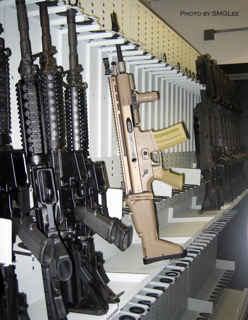

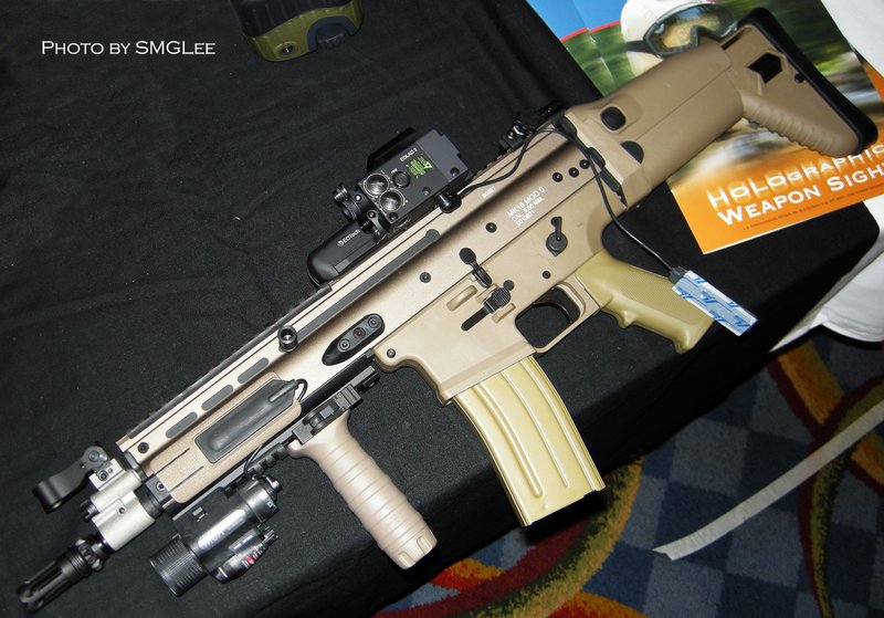

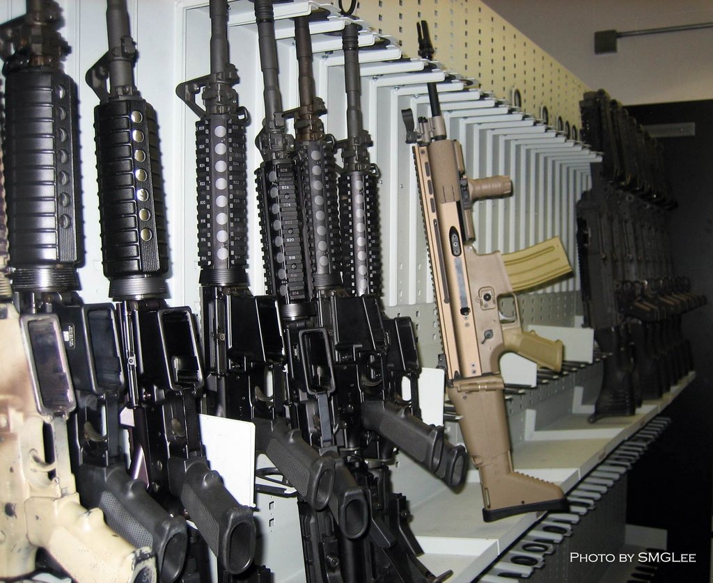

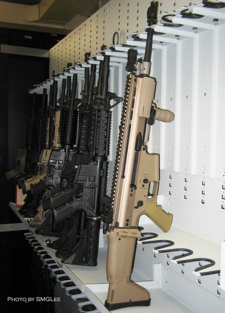

« Reply #24 on: February 16, 2009, 08:18:37 PM »
VFC SCAR are about the closest to the real thing, VFC SCAR even made it into the NSWC armory for a photo op...the amrory chief was surprised that a civilian was able to bring in a SCAR until he figured it was an airsoft...
One more, EOTech's VFC SCAR at a West coast SWAT Expo..The FN rep came by to check on how EOTech got a SCAR...LOL
