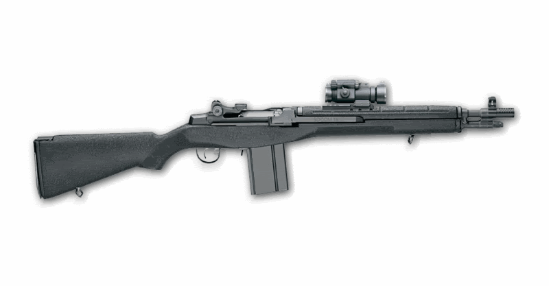

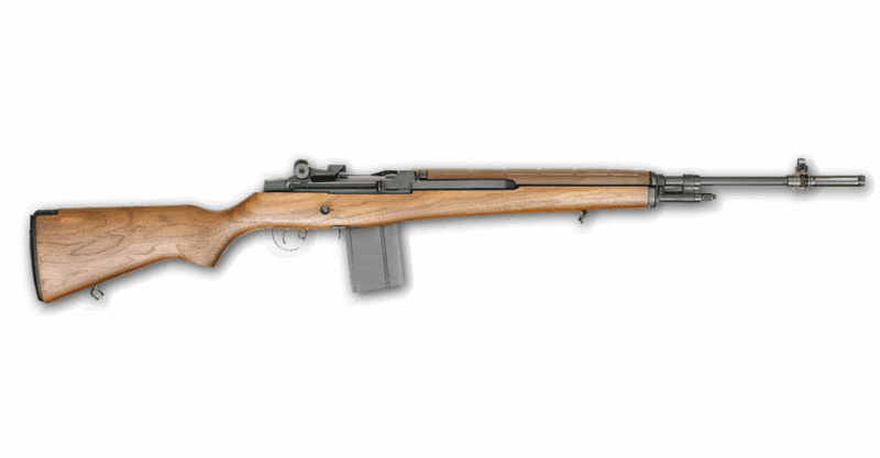

Before the review, here's a bit of history about the M14 SOC 16. It of course spawned from its older and larger brother, the Springfield Armory M14. The M14 was adopted by the U.S. military in 1957, spawned from the older M1 Garand, and saw combat use in South East Asia, most extensively in Vietnam. Production of the M14 was ceased by the U.S. military in 1964 due to its limitations in the combat it served in and was replaced by the lighter, better suited Colt M16. The gun was too long for use in the harsh jungles in which U.S. soldiers were occupied in, the 7.62 round the M14 fired was too large a caliber and limited the amount of ammunition a soldier could carry, and the gun was too heavy to carry around for long periods of time. The gun came with both semi-automatic and full-automatic functions, but the guns were quite often locked in semi-automatic due to the excessive muzzle climb and waste of ammunition when the gun was used in full-automatic. Although production of the M14 ceased, it has seen active military use to this day due to its farther range, accuracy, and power compared to its 5.56 Colt brethren.
http://i27.photobucket.com/albums/c186/Captain_Kev/MA9102.gif
The M14 was turned into the M1A by Springfield Armory as a civilian version of the classic gun, and variations of the gun were also produced. The most current variation of the M1A is the SOCOM 16, the SOCOM for Special Operations Command and the 16 meaning that it has just over a 16 inch barrel (just over the legal limit for a rifle of its type in the United States). It differs from the M14 in a few critical ways: the body is made from fiberglass as opposed to wood, making the weight drop to just under 10 pounds, it has been shortened to provide a more ergonomic shooting platform, and the recoil has been drastically reduced through the use of advanced recoil springs and a new generation flash hider. It retains the excellent accuracy, range, and power of the M14, while bringing the outdated M14 design into the 21st century.
http://i27.photobucket.com/albums/c186/Captain_Kev/AA9626.gif

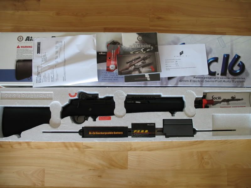

http://i27.photobucket.com/albums/c186/Captain_Kev/IMG_1178.jpg
After removing the plethora of papers and miscellaneous crap blocking the view of my baby, I finally saw it. But *******it there was still one more step; G&G's standard packaging is better than any company I have yet witnessed, and to protect the gun during shipping not only is the gun immersed in styrofoam and the styrofoam inserted into a box, but supporting the gun on top are three styrofoam blobs that prevent any movement of the gun whatsoever during transport.
Along with the gun, the package also contained:
-1x 470-rd hi-cap magazine
-Cleaning rod
-Manual
-G&G catalog
-Yellow bbs (not too great)
Airsoftgi also tested the gun before shipping and it chronoed at 380 FPS w/ Airsoft Elite .2g bbs.

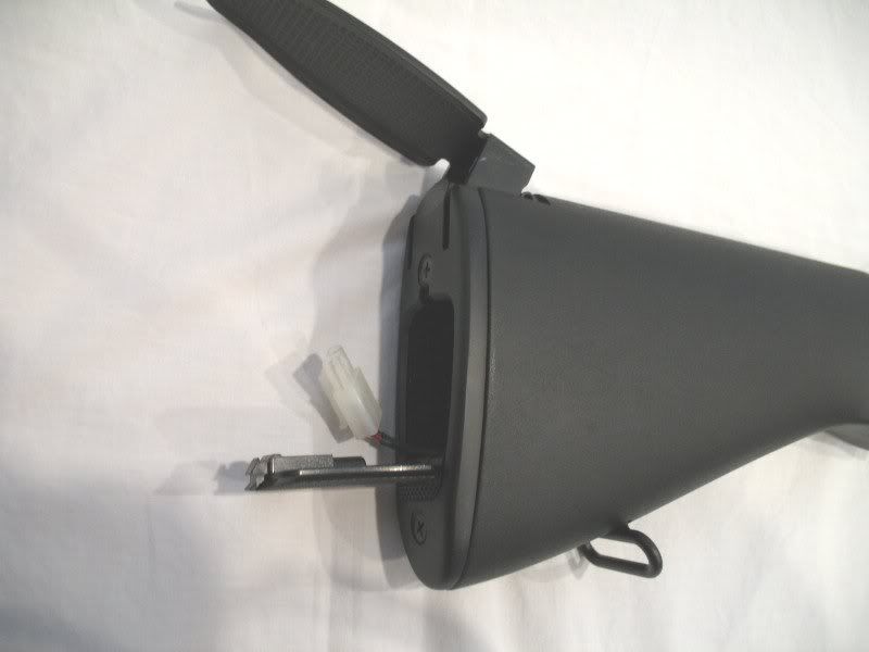

http://i27.photobucket.com/albums/c186/Captain_Kev/IMG_1184.jpg
Here is the battery compartment opened up. The butt plate is made out of metal with a nice checkered pattern that rests up against your shoulder and flips open to reveal another metal plate with a plastic battery door. Flipping open the door allows access to the massive battery compartment inside, capable of holding a 9.6v SC pack. The stock connector is a large Tamiya, as it should be.

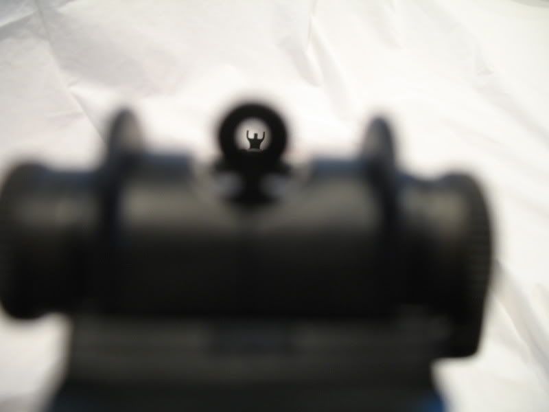

The rear sight has only one peephole and is adjustable not only up and down, but also side to side, all without tools. The rear sight doesn't actually move straight up and down, it's on a ramp that moves farther upward and backward the more you adjust it.
http://i27.photobucket.com/albums/c186/Captain_Kev/IMG_1223.jpg
Looking down the sights.

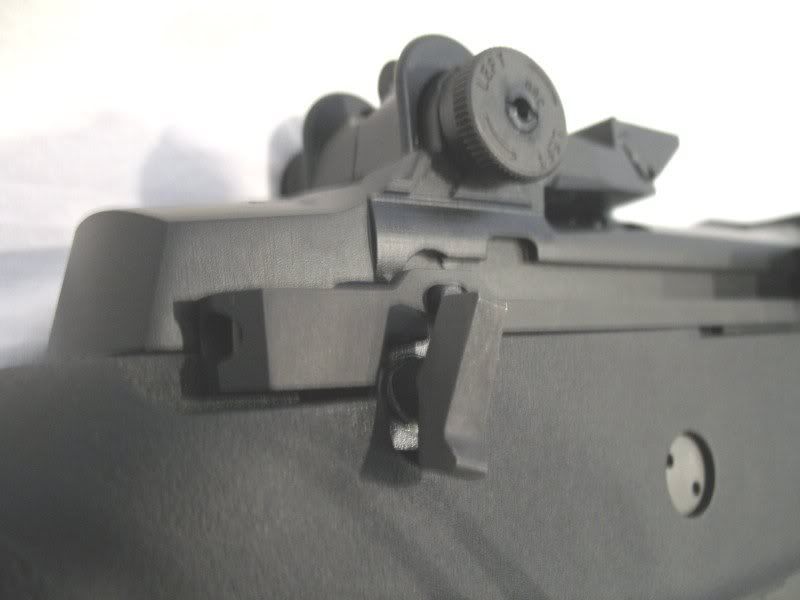

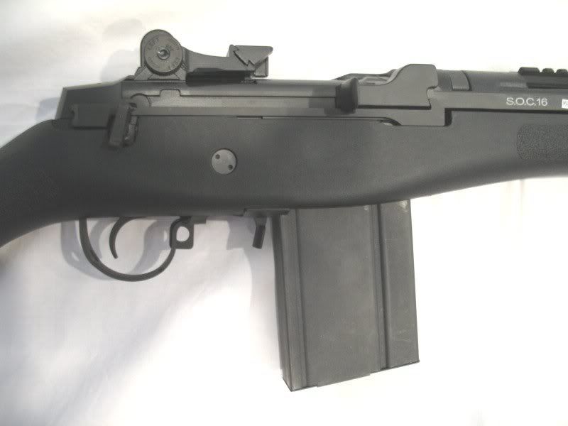

http://i27.photobucket.com/albums/c186/Captain_Kev/IMG_1189.jpg
And here is one of the worst features of all M14s: the selector switch. To switch from semi-auto to full-auto, one must push in the bar that functions as a selector switch and turn it 180 degrees, where an engraved "A" will tell you that you are now shooting on full-auto. Definitely not the quickest or most effective ways to switch firing functions. The entire switch system wobbles a bit and detracts from the overall quality feel of the gun, although this is the case with every M14.
The safety is not part of the selector switch but is instead located in front of the trigger guard as a little switch that is flicked away for shooting and toward the trigger for safe.

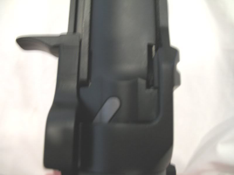

http://i27.photobucket.com/albums/c186/Captain_Kev/IMG_1205.jpg
This is a picture of the receiver right in front of the rear sight and the end of the bolt cover. There is a block of metal with a set screw that slides into position either covering the trademarks below and flush with the top of the receiver *or* can be slid out of position and slid in in a vertical position, creating two posts to aim through while looking down the iron sights. The only problem I have found with this is that the set screw used is extremely small and of the some 50 hex tools I own the only ones small enough to fit into the head are the ones included with some AEPs.

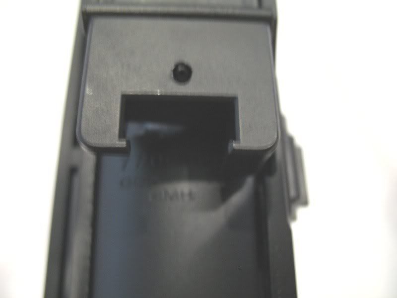

http://i27.photobucket.com/albums/c186/Captain_Kev/IMG_1204.jpg
More trademarks are located underneath the block. They read:
7700168
GGA 14
HMH

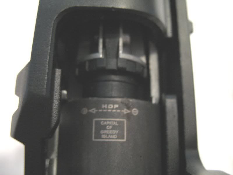

http://i27.photobucket.com/albums/c186/Captain_Kev/IMG_1216.jpg
The full metal hop-up unit and trademarks that are revealed when the bolt is pulled back. Part of the markings underneath tells you which way to turn the hop-up for more/less hop, the other says "Capital of Greedy Island".
Chaoswithinthed elaborated on what he believes to be the meaning of "Greedy Island":
"This is just an idea, but I think I know what "Capital of Greedy Island" might mean. I know that when NAM reviewed their first run of M14 they gave G&G the nickname of Greedy and Garbage. Another store reviewed the G&G M14 and used the same nickname and gave the M14 a horrible rating. G&G saw the article, and threatened to stop selling to them unless they raised the rating. Maybe this is G&Gs way of being funny?"

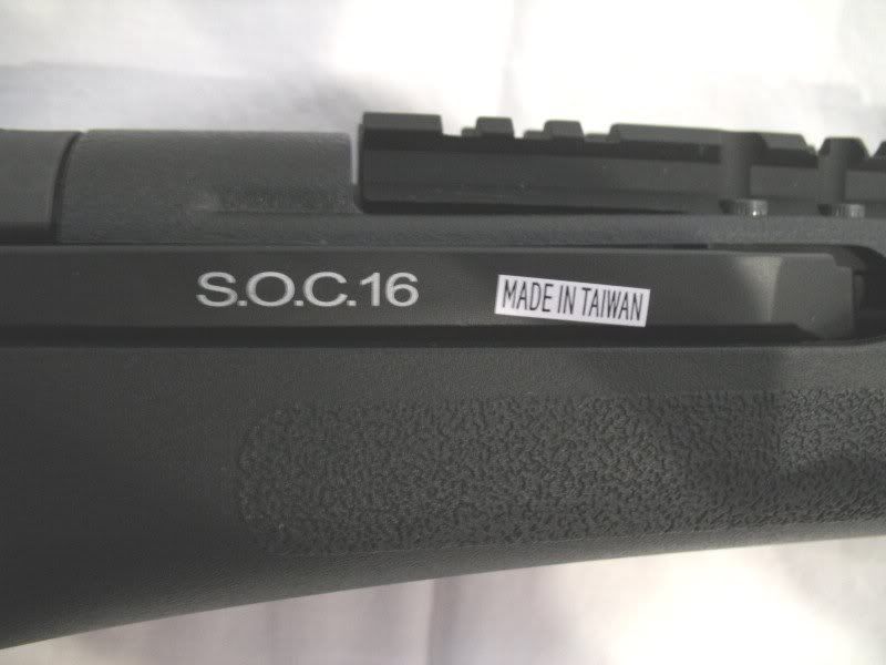

http://i27.photobucket.com/albums/c186/Captain_Kev/IMG_1182.jpg
Made in Taiwan and proud of it. The S.O.C. 16 white markings are the most visible and last of the external markings on the G&G. Also note the use of more of the same rough texture used on the grip of the gun.

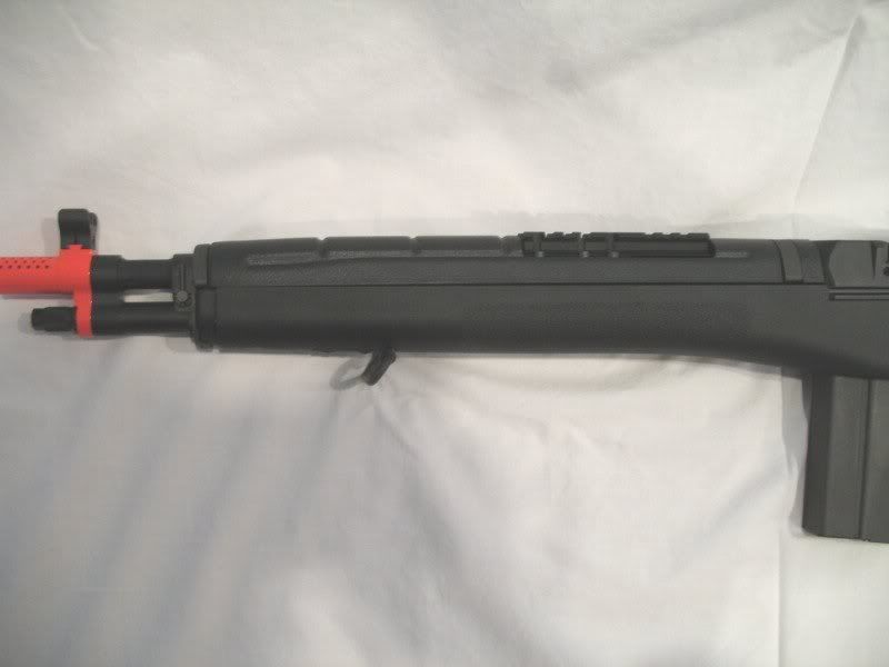

And now we move on to the front section of the gun.
http://i27.photobucket.com/albums/c186/Captain_Kev/IMG_1213.jpg
The CNC-machined aluminum rail is extremely solid and will accepts a wide variety of mounts. If you want to mount a high powered scope to your gun, sorry, but you purchased the wrong M14. This mount is meant almost exclusively for red dot sights, reflex sights, holosights, or any other optic that has extremely good eye relief. Sorry for whoever was looking forward to using magnified optics on this gun, you should have bought the standard M14. Wink

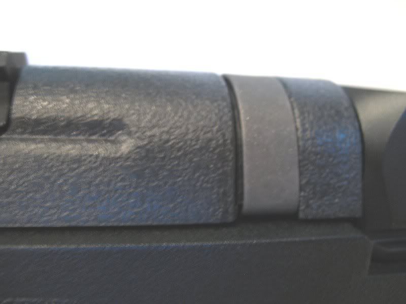

http://i27.photobucket.com/albums/c186/Captain_Kev/IMG_1218.jpg
Here is, without doubt, the worst external feature of the G&G SOC 16: the heat shield. It is made out of nicely textured but very flimsy plastic that is even flimsier on the SOC 16 due to the space in the middle needed for the rail to fit through (note that the rail and the heat shield are completely separate pieces). It flexes, wobbles, and just detracts from the overall high quality feel of the gun. Fortunately the G&G accepts real M14 heat shields that can be bought for relatively cheap and modified to fit the scope mount.

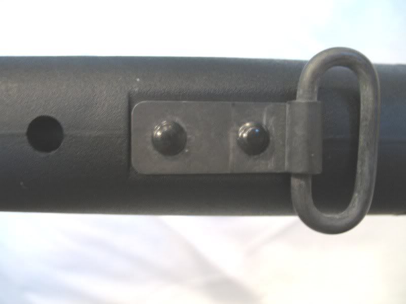

http://i27.photobucket.com/albums/c186/Captain_Kev/IMG_1220.jpg
The front sling mount. It is securely mounted to the receiver by two screws and is made out of metal, and definitely likes to flop around. In front of the sling mount is a hole that I can only presume functions as a way to mount an optional bi-pod of sorts.

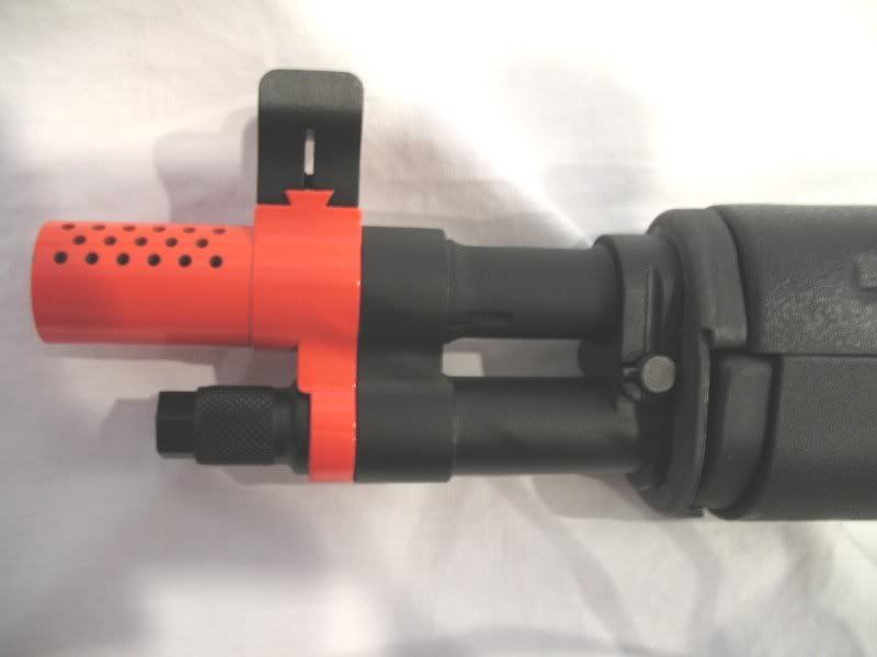

http://i27.photobucket.com/albums/c186/Captain_Kev/IMG_1221.jpg
Finally we come to the end of the gun, with the gas tube, flash hider, and front sight, all of which are metal. The front sight can be adjusted from left to right and is mounted to the bright orange flash hider assembly. Speaking of the flash hider, it is non-removable, although the entire section painted in orange can be removed.

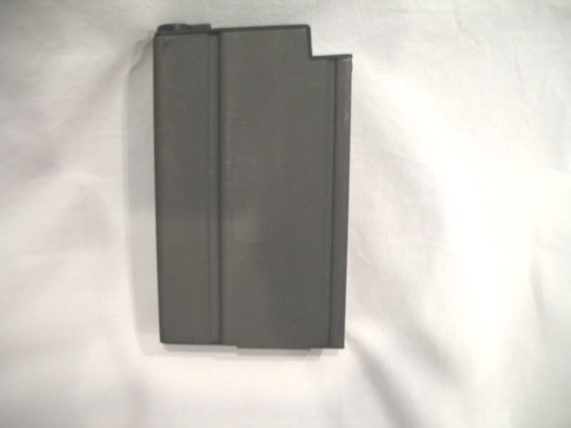

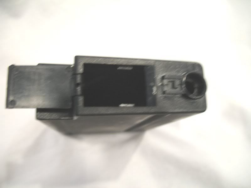

http://i27.photobucket.com/albums/c186/Captain_Kev/IMG_1227.jpg
http://i27.photobucket.com/albums/c186/Captain_Kev/IMG_1230.jpg
The magazines of the G&G SOC 16 are another problem: the only magazines compatible with the gun are G&G 470 round metal hi-caps, CA mags, or the hard-to-find and pricey G&G 80 round standard-caps.
Both hi-caps I received fed flawlessly, are metal with a very nice gray sparkly finish, and are very easy to load due to the massive feed door.
Another problem I found with this gun is that the magazines are unnecessarily difficult to mount into the mag well at first. They must be caught at a certain place and then locked back into position, and when the gun is brand new it takes two to three tries before it finally clicks in correctly. After a little while though the system gets broken in and mag changes become as they should be.

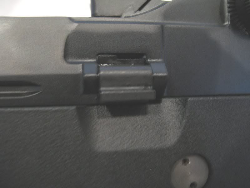

http://i27.photobucket.com/albums/c186/Captain_Kev/IMG_1231.jpg
First, just yank down on the rear of the trigger guard, popping it loose.

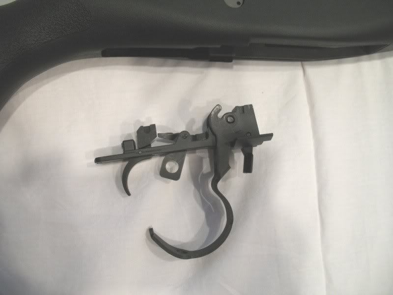

http://i27.photobucket.com/albums/c186/Captain_Kev/IMG_1232.jpg
Then the entire trigger mechanism will just slide out

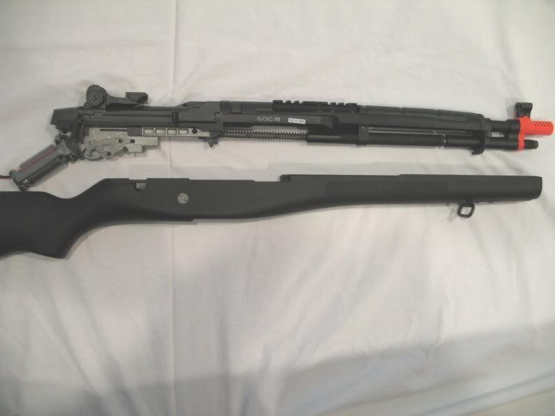

http://i27.photobucket.com/albums/c186/Captain_Kev/IMG_1233.jpg
And you can just remove the upper receiver from the lower receiver.

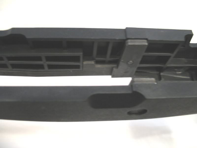

http://i27.photobucket.com/albums/c186/Captain_Kev/IMG_1234.jpg
Here is a better look of how the lower ABS receiver is constructed and why it's so durable.

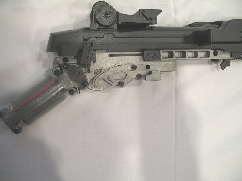

http://i27.photobucket.com/albums/c186/Captain_Kev/IMG_1235.jpg
The first shot of the gearbox. Yes, it is an absolute beast, larger than any other gearbox I have seen save pictures of the CA M249 gearbox. The trigger mechanism is on the left side of the gearbox, which is far easier to deal with than the TM design. Just a simple metal plate that is pushed in and out with each pull of the trigger and connects the contacts located on the inside of the gearbox. This is most definitely no v7 gearbox, but actually a patented new version gearbox made specifically by G&G for their M14 series.

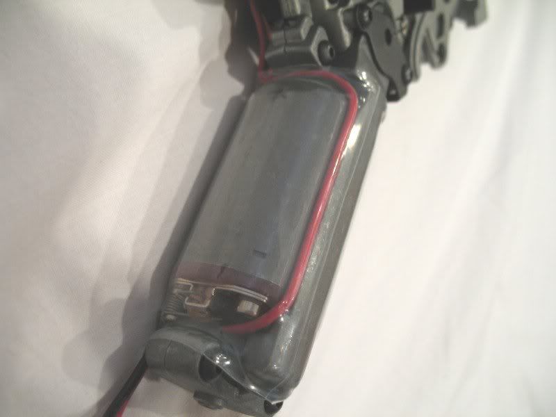

http://i27.photobucket.com/albums/c186/Captain_Kev/IMG_1236.jpg
The small-type motor is a 25000 RPM small type wrapped in shrink wrap to make sure it hugs the wiring. Not sure if I feel comfortable having the wiring right up against the motor which can get really hot, but I don't plan to use this gun on really long bursts anyway.

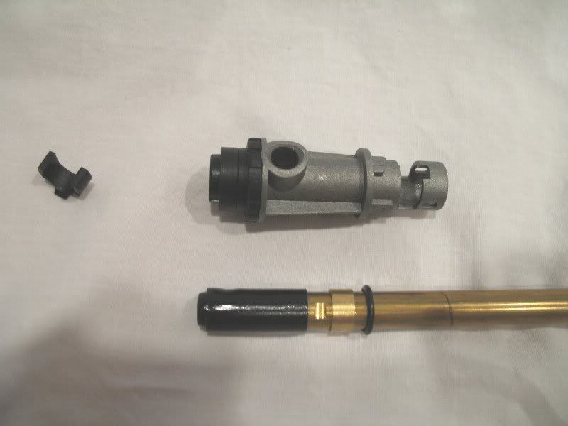

http://i27.photobucket.com/albums/c186/Captain_Kev/IMG_1246.jpg
This shows the hop-up unit disassembled. Anyone recognize it? That's right, it's the same one used in the AUG. Having upgraded my TM AUG's barrel and hop-up many many times before I was right at home with this one, and it also means that the G&G is 100% compatible with aftermarket hop-up rubbers and barrels.
A few things I noticed: the metal used on the hop-up unit itself is very high quality, better than aftermarket CA metal hop-up units I have installed. It comes with a quite long barrel spacer that stabilizes the barrel in the chamber, as well as a rubber O-ring that fits on the end. The rubber seems hard, fit for a gun that shoots at ~400 FPS out of the box. All of these parts fit together very well, staying put when you want them to and sliding out quite nicely when you want them out. The adjustment wheel feels very loose when the assembly is removed from the rest of the upper receiver but tight when it is assembled, so I can only presume that the gearbox/hop-up seal is very good if they are being pressed against each other.
After disassembly of the barrel/hop-up I cleaned the barrel with a lint-free cloth and removed the traditional grudge out of it. I also washed off the hop-up rubber to get any grease off that could affect performance.

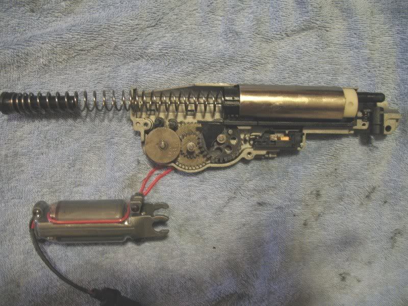

http://i27.photobucket.com/albums/c186/Captain_Kev/IMG_1251.jpg
The gearbox in all its glory!
http://i27.photobucket.com/albums/c186/Captain_Kev/IMG_1253.jpg
Here is the spring and spring guide. The spring is non-linear and feels and performs like an M115. The spring guide is a standard v3 has a metal base and a very thick washer that acts kind of like a bearing spring guide. It flew out and hit my wall when I took the gearbox apart. I was thinking of adding a spare ball bearing v3 spring guide I had lying around but decided that the stock one was more than good enough.
http://i27.photobucket.com/albums/c186/Captain_Kev/IMG_1257.jpg
Here is a good view of the gears. They have definitely been revised since the v3 of the SOC 16 and looked flawless and very well greased upon inspection. They are a standard steel v2/v3 gearset with the black sector gear standing out among the rest.
Stock shimming was decent. The bevel had a bit of movement, fixed by adding about .15mm of shimmage on the right side, and the same was true with the spur gear. The sector was shimmed perfectly but was a bit too close to the spur gear, fixed after swapping just a few shims.
Note that every gear had a shim and different sized shims were used.

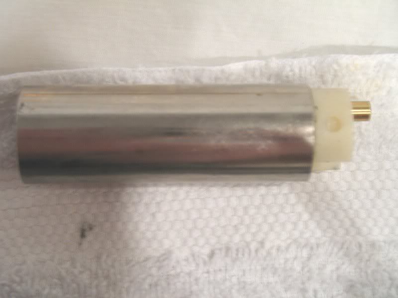

http://i27.photobucket.com/albums/c186/Captain_Kev/IMG_1263.jpg
Here is the cylinder/cylinder head. The cylinder looks to be made of stainless steel and is sealed very well with the stock cylinder head, neither of which are compatible with aftermarket parts. The cylinder is just slightly thinner than most, making aftermarket cylinders unable to fit in the gearbox shell, and the cylinder head is meant to fit in the cylinder, so it is also not compatible. The air nozzle is an AUG type that slides on the cylinder head has an internal O-ring that creates a nearly perfect seal all around. The tappet plate also looks to be very nice and I can only imagine that with the inclusion of a farther track for it to move that it won't suffer breakage anytime soon. You can see the tappet plate move through the side of the gearbox so if it breaks or has any sort of problem you can diagnose it without having to open up the gearbox.

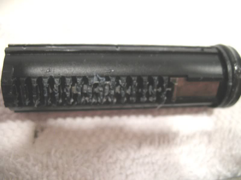

http://i27.photobucket.com/albums/c186/Captain_Kev/IMG_1264.jpg
Here is the piston, looks and feels like polycarbonate. First impressions are that it looks really nice and should hold up for quite a while.

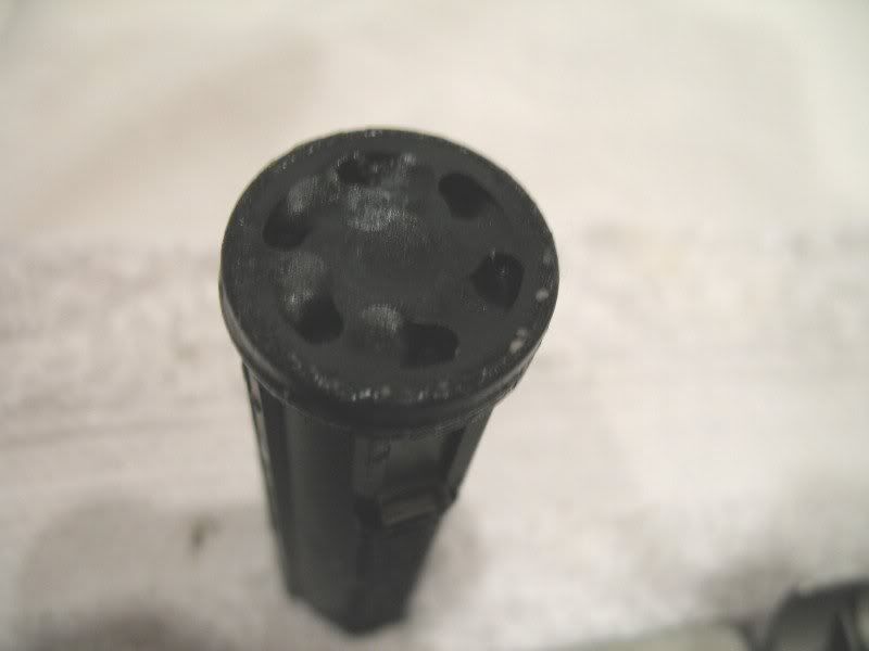

http://i27.photobucket.com/albums/c186/Captain_Kev/IMG_1265.jpg
The piston head is like nothing I've ever seen before. The ports in the head are tear-drop shaped and if nothing else look really cool. The stock O-ring smaller than most provided for poor compression (at least at the velocities I could get the piston going at, it is ported after all) so I swapped it out for a new one which will not deteriorate under heat or when used with petroleum products. It was a tight fit with the thinner cylinder but provided a very nice seal.

After more than 5,000 rounds had been put through the rifle I decided to open the gun up to see if I could notice any premature wear. Everything in the gearbox looked the same as it had been the day I got it. There were no signs of wear on any of the gears or the pinion gear on the motor and the piston looked brand new. I am very confident that this gun will last me a very long time.
